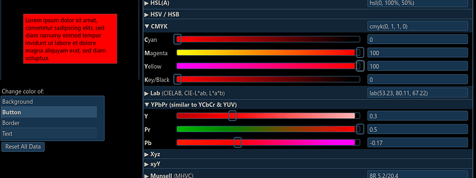

Regarding the red pen, I think it’s for this reason:
It’s true that maybe this particular example of mine isn’t a good one, because my red pen dried out (that’s why I only wrote “Ve” instead of “Red”).

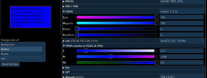

But notice how red, when viewed monochromatically (converted to grayscale), has a lower visibility (higher luminance) than blue.
Even when we consider the pure blue and the pure red, there is a luminance difference when they are converted, for example, to a YUV/YCbCr/YPbPr space (a smaller Y means lower luminance, which means darker/closer to black):
The paper’s background (that is, the answer sheet’s background color, for example) also has its luminance, and the relationship between these two luminances (paper background and pen marking) yields what we call “contrast”: the smaller the difference, the lower the contrast. The paper is usually “white”, but it’s not an absolute white. This paper, even in my example (a page from a school notebook), is not #FFFFFF, being actually a silvery gray, slightly tinted toward red (although I have a red curtain in the room and perhaps those two extra levels of red are remnants of reflection from the curtain on the paper):
What leads us to ask the following: why don’t they accept a black pen? After all, a black pen would be even better than a blue pen, with luminance as close to zero as possible and, therefore, the greatest possible contrast.
