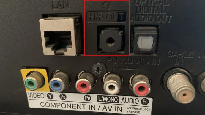

Does your TV have a headphone jack? I have an old Samsung LCD TV here from 2014. It can send audio to both that output and the TV’s speakers.
In fact, @tecnoblog has already posted a step-by-step guide, at this link.
A headphone jack looks like this:

What’s your TV like, does it have a headphone jack?

Good morning Matheus. My TV is a Samsung series 8000, it doesn’t have a 3.5mm jack, only digital… Thank you for your attention.
From what I’ve seen, your TV has an optical audio output, so you can do:
1 - (easier, more expensive) you connect the TV to the adapter and the adapter itself shares it Mercado Libre?
2 - (harder, cheaper) you’ll connect from the TV to RCA cable, from there you can connect to a PC via a microphone P2 adapter/converter and on the computer you split it for everyone, speaker, headset. Or you can use an RCA splitter for three ways, one you send to some equipment you have that has an RCA input (speaker, home theater) and the other two ways to an RCA to P2 headphone adapter. Mercado Libre?
